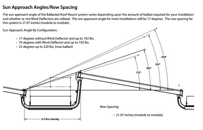

@MickS  I totally feel ya. Man Tongue I'm running into the same issues with my installer.  I finally did my own research and found a ton of information on this site.  I've attached a data sheet for you as well.
This diagram was super helpful to explain to my installer:
