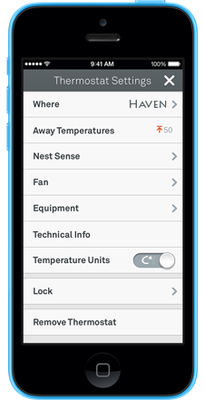

Making the change in the Haven app (IOS/Android only):
1.  Log in to your Haven Account on the Web or Mobile app.
2.  Select your Haven thermostat.
3.  Select the settings icon in the upper right of the window.
4.  Select Thermostat settings.
5.  Tap or Click the Temperature Units option to switch between Fahrenheit and Celcius. Haven - mobile-app-settings.png
